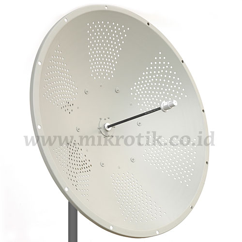

5.8GHz High-Performance Parabolic Dish WiFi Antenna is ideal for directional 5.8GHz ISM / UNII band applications. It features 32 dBi with a 5° beam-width. These antennas can be oriented for either vertical or horizontal polarization.
The reflector dish of these antennas are constructed from high quality aluminum which gives them superior strength. The dish is coated in a light gray UV-inhibited polymer for durability and aesthetics. Perforated holes in the dish helps minimize wind loading.
These antennas are supplied with a tilt and swivel mast mount kit. This allows installation at various degrees of incline for easy alignment. It can be adjusted up or down from 0° to 30°.Seluruh harga yang tercantum di atas belum termasuk PPN 10% dan biaya pengiriman.
- Frequency 5725-5850 MHz
- Gain 32 dBi
- Polarization Horizontal or Vertical
- Horizontal Beam Width 5°
- Vertical Beam Width 5°
- Front to Back Ratio 38 dB
- Impedance 50 Ohm
- Max. Input Power 100 Watts
- VSWR < 1.5:1 avg.
- Weight 20 lbs. (9 kg)
- Diameter 35.4 in. (900 mm)
- Mounting 1.5" (38mm) to 3" (76mm) dia. masts
- Operating Temperature -40° C to to 85° C
- Lighting Protection DC Ground
- Connector N-Female
